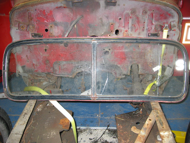

          I have my windshield so it opens very easy. Now after I take out the two bottom bolts how do I seperate the windshield from the hinges so I can take the windshield apart to replace the the glass paint it and replace all the bolts. Also where can I get a new gasket (the one that goes between the windshield frame and the opening in the cab).
            To take out the windshield you unbolt it from the hinges behind the wiper covers. The curved pieces stay with the windshield frame.
            You can just see the heads of the bolts in the picture.
            Once its out there are screws on each side about mid way between top and bottom. You can see the seam in the picture.
            Again, lots of penetrating fluid will probably be needed, wax seems to work well too. There is a piece of key stock that joins the two halves. You really only have to remove two screws from each side to take it apart. You may want to remove the other two to treat the inside of the frame though.
            The strip in the center is protective/decrative and gets removed as one piece. I don't think there's any fasteners in the center piece, but I don't remember off the top of my head. Regardless it's not complex, just takes some care, time, and probably some sort of tool to help break the seal around the glass.
            As for the gasket I think VPW has them, I think there are a few other places.
