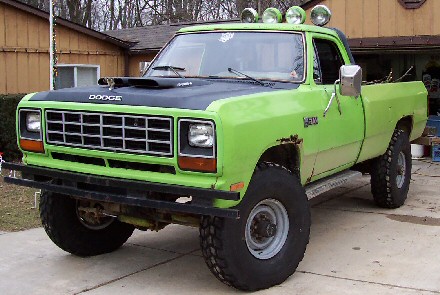

    Here is a picture of one of my trucks. I call this one Brutus.
    I really named the truck before I found it. Had to find a truck to fit the name. He is cloaked as a 1984 3/4t Dodge. Was a 2 wheel drive truck painted silver with red interior.
    Under the hood rests a 440, with a 727 Auto and a NP-205 transfer. Rear axle is a Dana 70, front is a Dana 60. Geared at 4:10.
    Tires he is wearing now are some Michelin 11r16's type "S"
    yes they really are type "S".
    he is also sporting some looks/badging from a muscle car.
    I have never verified if the block is a true 440Mag.
    I don't use him much other then driving around. He is a little tempermental and won't start after I run him for short distances.
    Needs a whole new ignition system and I don't have the money
    just yet nor what exactly to buy him.
    Future plans, I really bought him for the drivetrain. I had thoughts of putting the drivetrain under a 41 or 42 PW. But I can't find a cab/front clip which is affordable nore the fact that many people would not like such a chop. I have since obtained a 1979 Plymouth Trailduster which is pretty much rust free.
    My plan would be to take the drivetrain from the pick-up and put it under the trailduster with a few modifications.
    re-gear the axles to 4:89 or higher depending on final tire size.
    I would like to be between 40 and 50" tire diameter.
    Need lockers of some sort. I also plan on a double transfercase.
    Well that is the plan... we shall see.

    Pieter Looks like you got the name right on that truck, BRUTUS. It looks like a real bad boy there. The Trailduster build sounds like a plan and would be cool also. What drivetrain is in the Trailduster? Do you have a place close to play in with those trucks? I can't wait to go to the Monteagle rally in TN or back out to Vermont. You owe it to yourself to go to Vermont at least once. Keep up the good job and keep us posted on your progress. You are or aren't going to Iowa this year?

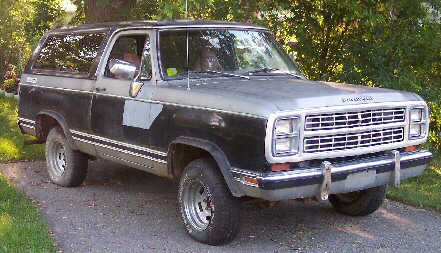

      Here is an update of one of my other trucks. 1979 Plymouth Trailduster. Truck came out of New Mexico so it is almost 100% rust free. Plus with the full removable top, it's going to be a blast...
      Took it for it's last drive today in it's original state. The next drive it will be sporting a 440, dana 60 front, dana 70 rear and 11r16's... ;o)

          I like the TraiDuster, I had a lead on a 77 Power Wagon Ramcharger with a dead 383 and removable top, but she was in sad shape.
