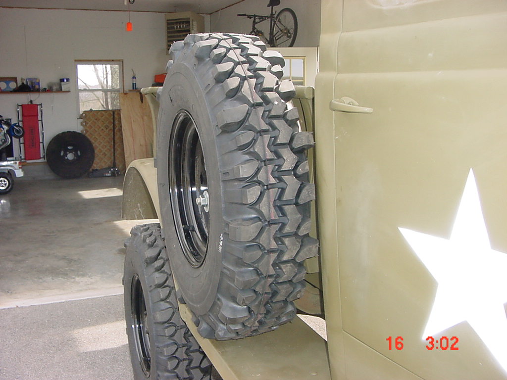

      Kurt - the wheels are from Stockton wheel. They are very heavy duty and I think they will do the job quite well. Let's just say I've not had good luck with split ring wheels and leave it at that. I kept them but I think these will be easier to service and repair if needed. The tires are TSL Swampers, they are radial tires and 8 ply (I think). I can verify the ply if needed. I read so many articles about tires, I was sick of reading. These are supposed to be good for low horsepower trucks, like mine. I haven't really tried them out yet but definately plan to. We have a trail ride scheduled for later next month. It will be my first outing with other trucks. They ride very well considering what they are mounted to. Here's a closer shot......

        Looks like a great combo. If you get a chance I would like the specs on the Stockton wheels (offset, width, powder coat?) and the tire size also. Thanks. Kurt
          wheel/tire info.
          wheels-
          Stockton Wheel
          16x7 - 5 on 6 7/8 spacing
          4.25" back spacing
          black powder coat
          tires -
          TSL Swamper's
          34 x 9/16

                Wheels - $165 each
                Tires - $104 each
                Pretty dang expensive for what they are but I think they are built for the long haul.

                  Expensive? That's a pretty good tire price! Stockton Wheels have never been cheap, but they are good.
                    Price
                    I was very happy with the tire price but the wheel price seemed high. Once I received the wheels, I knew why they were priced that way. The center plate is 1/2" thick and the machining looks really good, powder coat looks good as well. I think they are a quality wheel, we'll see.
