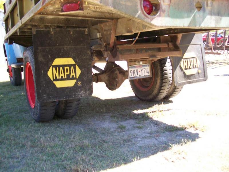

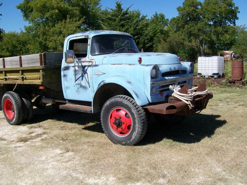

    Here's a neat old W500 that appears to get frequent use.
    The Timken rear axle is different from my 66 W500, as is the t-case.
    Front winch is a Tulsa, I believe driven off the t-case. Transmission PTO drives hydraulic dump bed.

    That looks like a nice one.
    If anyone ever spots one that is being parted out, please let me know. I need a few parts that are 57 W500 specific and would like to return mine to original.

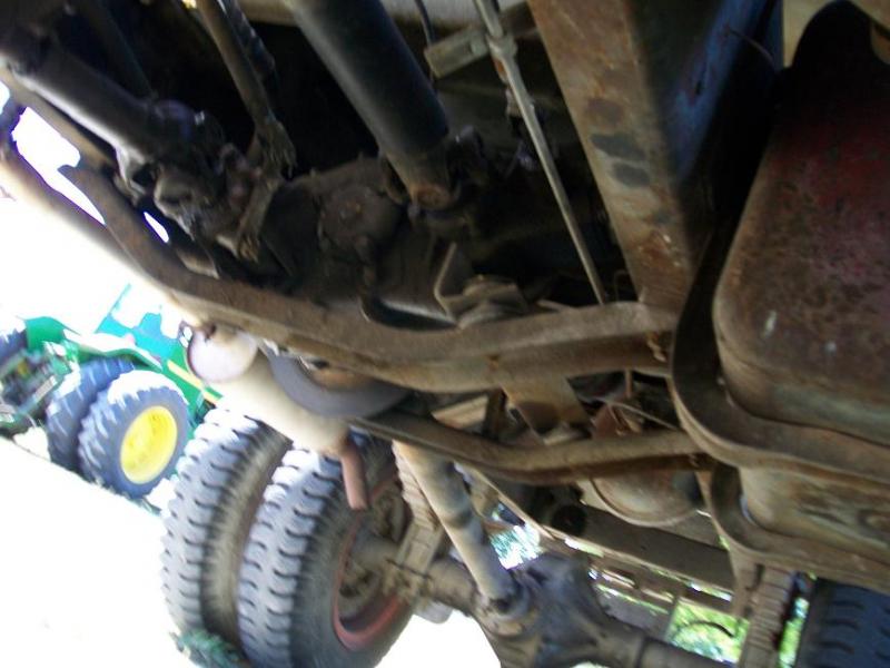

      rear pic of transmission
      The PTO off of the transmission heads back to a pump for the hydraulic ram/dump bed.
      Many of the components on this truck vary greatly from my 66 W500, including rear axle & transfer case.

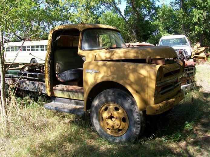

          Also there was a 57? D500 there today that I got a shot of.
