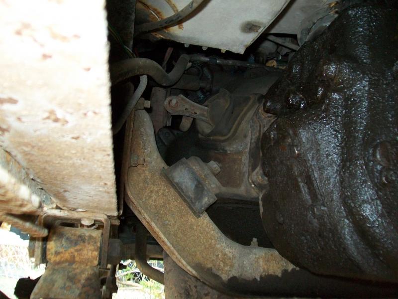

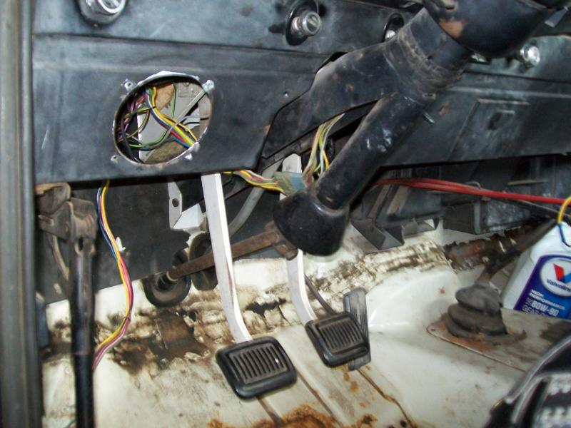

Notice the bellhousing. Has the mounts same as the pre 1969 hydraulic clutch bells, BUT clutch is mechanical and on the driver's side. This bell has windows on both sides. Lighter duty mechanical clutch trucks (69-80's) use a tailshaft mount & not on the bellhousing.

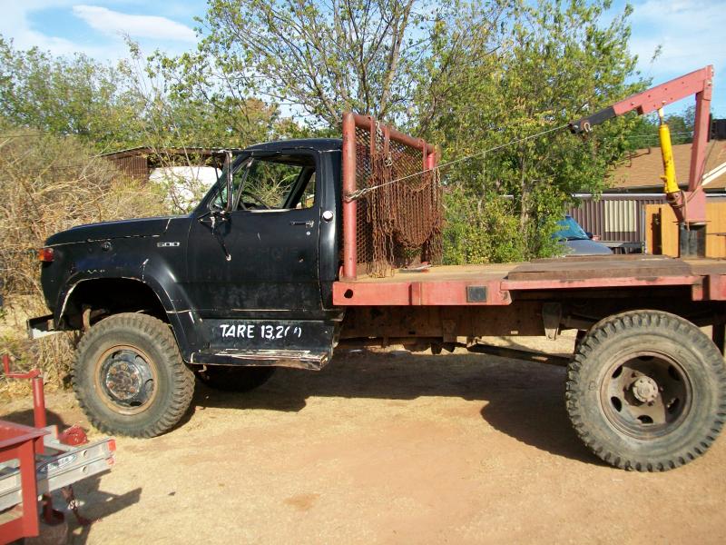

My 75 W600 in Kremmling, Colo
More shots
Tires are just a tad under 40" tall. Gas tank is in cab, which doesn't bother me. No shoulder belts, only lap belts.

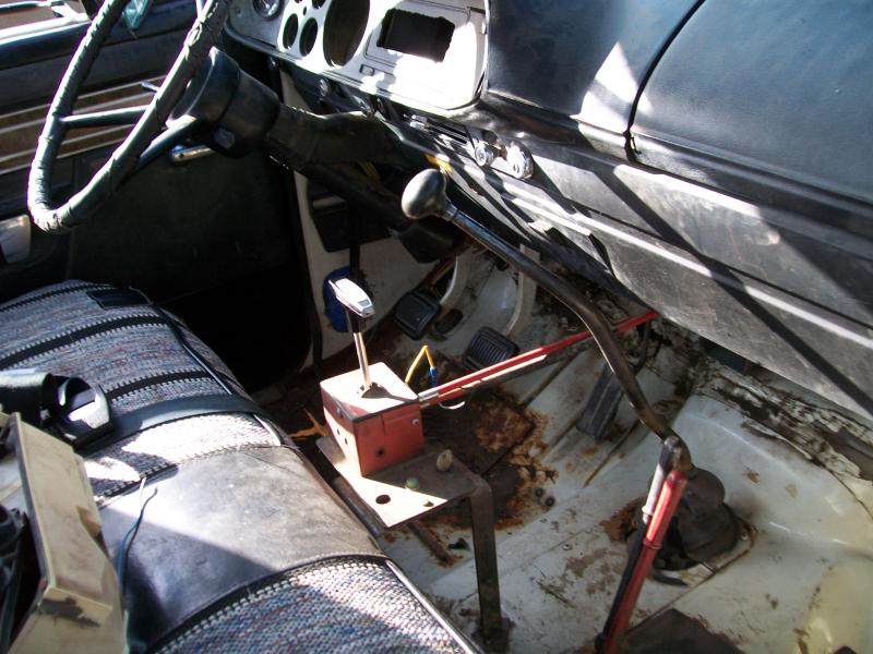

Transmission is NP540 with 7.41 low
T-case is Rockwell T223 & has less than 200 miles since rebuild. I found a vendor who lists used T223's for @ $2300 & rebuilt ones for @ $3800.... so I am keeping the one from my 66 W500.

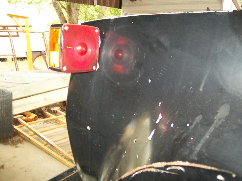

I installed new tail-lamp assemblies & new wiring from the firewall connector back. I used a wiring kit for trailers. I still need to replace the remains of the cab clearance lights.

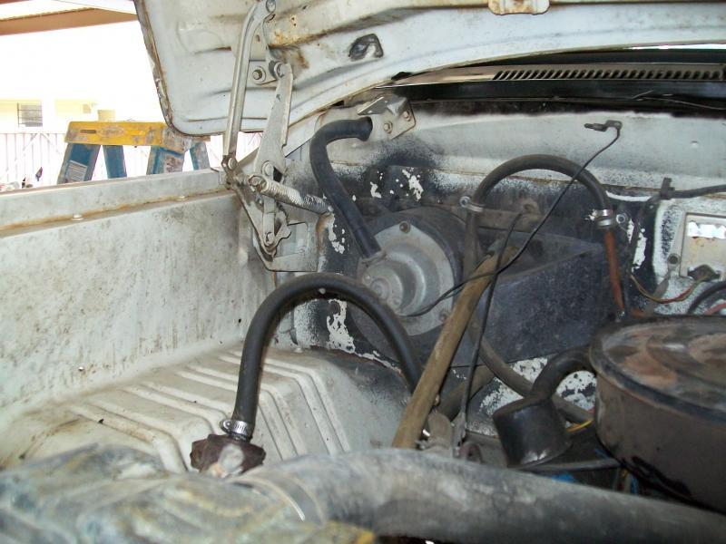

Engine is an LA318-3 with 2V carb. Truck has manual choke & a manual throttle knob to hold engine at a set RPM, sorta a redneck cruise control. No A/C, just hopefully a good heater/defroster.

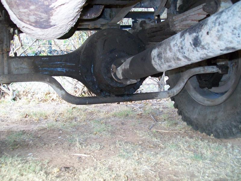

BTW axle ratios are 6.8:1

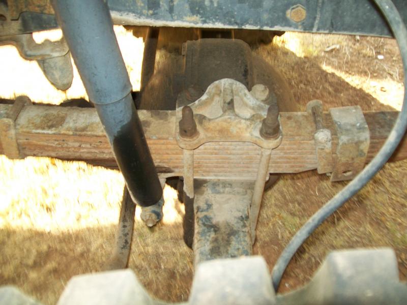

I have had her up to 45mph & it honestly will go 10-15mph more, but I don't have the courage to push that much weight that fast with those ol big drum brakes & that sasquatch suspension/drivetrain. While tooling around the neighborhood I often am going slower than 20mph in 4th.

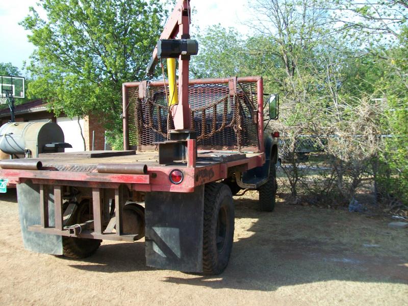

That rear "bracket" with the 2 sections of pipe at the tailend of the flatbed actually has 2 pins which can be removed & the "bumper" can be extended out making the flatbed anoth 4' longer. Plus the previous owner had a "goalpost" attachment that mounted to the verticle square tubing on the front bumper & extended upward to be level with the headache rack. This allowed for overhead carrying of logs that were longer than the truck (A goalpost type rack was fitted to the rear of the truck too. It fit on the verticle square tubing seen in the picture).
More data
This truck has a 156" wheelbase, about the same as a modern extended or quad cab pick-up, yet it doesn't look any longer than any conventional cab run of the mill flatbed dually, due to the extreme height. Top of cab is @ 94". Headache rack & hoist are a tad higher.
Width at outside of front tires is about 93".

Most of these W600's came with a Dana 70 front, I think rated at #4500. The Rockwell is rated at #7500.

The truck has power brakes, vacuum booster & tank are mounted on the frame just below driver's side floorboard. I don't think discs are available for Rockwell sideloader. The more common military top-loaders are often fitted with an inboard (on the pumpkin, not at the wheel) disc brake rotor (1 per axle).

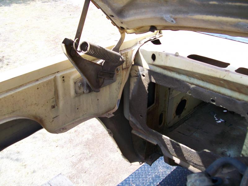

Here is some shots showing the difference in how the hoods mount. The yellow is a 1979 W200 & the hood hinges bolt to the inner fender. The white is the W600 & it is more like the older Sweptline hood hinges, bolts to the firewall & the hood opens almost 90 degrees.

Fenders had huge wheelwell openings. Hoods/grill & basically everything from firewall forward were unique to the med duty trucks.

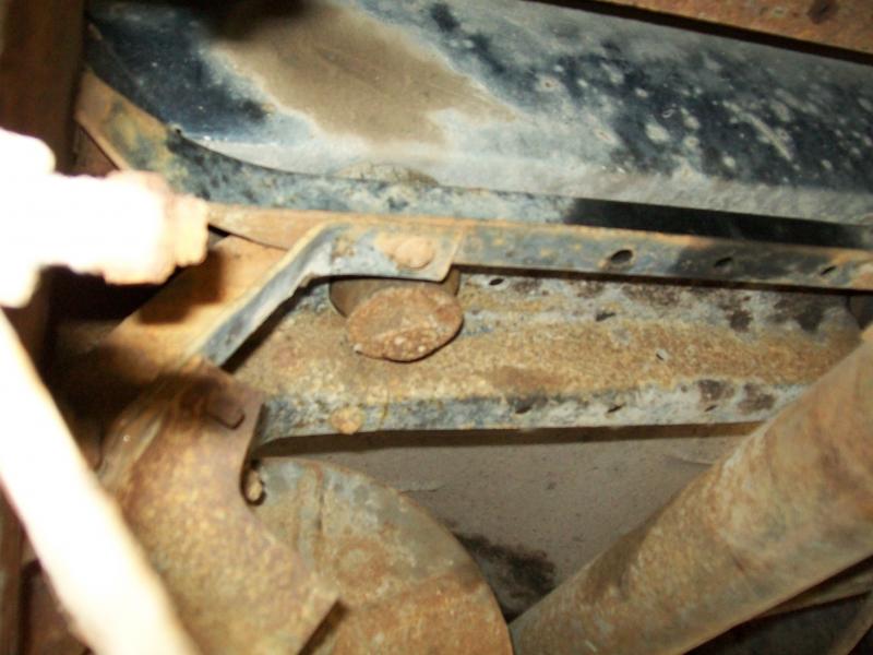

Medium duty trucks had the rear cab mounts located inboard of the frame rails, using a crossmember. (Shown)
The more common 100/200/300 cabs had the rear cab mounts outside the the frame rails.

the NP540 shifts with same effort as a 435.

I got the parking brake working good. Had to reworking the linkage to remove ALL slack, plus reverse the shoes to put the "meatier" one in the sliding position.
