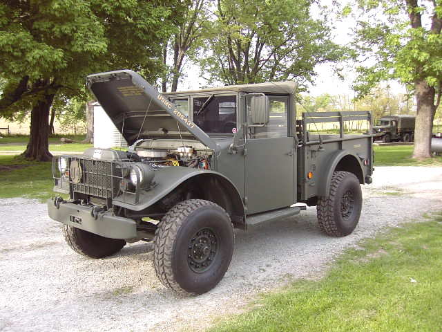

    This is my first post.( don't type to well and can't spell worth a dang) I want to add my truck to your sight.

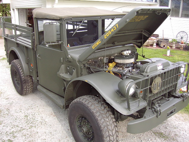

    This is my second M37,my first was a ground up stock restoration which I sold five years ago.This truck had alot of parts missing and came with a blown (civilian) flat head six.This is what the truck has evolved into at this point in time since I started on it in about 1999.
    It has a 318,np 435, stock np 200, stock axles with 4.89 gears,power steering,modified m-37 hubs,four wheel disc brakes,wilwood hanging pedals and remote clutch and brake master cylinders.
    There are a few things I plan to improve on next winter but for now I just want it ready for th MV Season ( MV Rallys and Airshows)My wife and I also
    have a M35A2c we take to the events.Thanks again for the great Forum.
    Fred

    Sweet looking truck, thanks for the pictures!
      Thank's for the compliment Bobby. I'm glad the pictures posted.The first ones I tried to send were to large so I had to take them over today.

        Wow! Great looking truck!
          Looking Real Good
