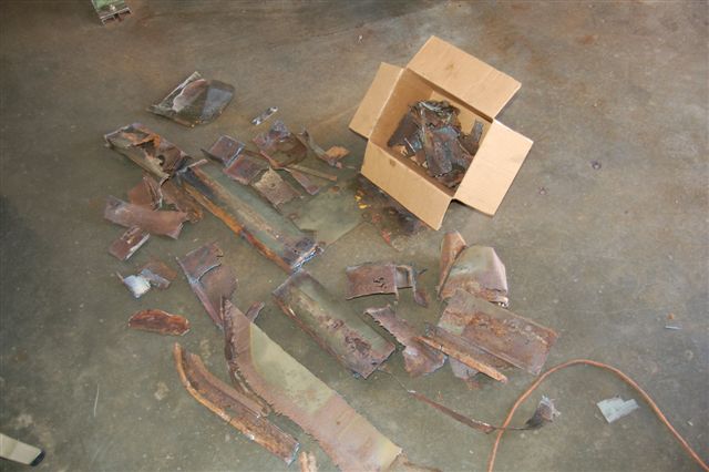

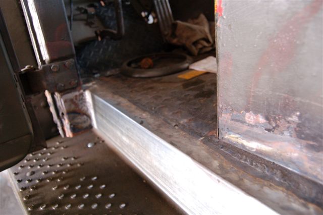

    Hello,
    Things are going slowly but the rust is slowly being cut out and replaced around the cab....
    A couple of photos of the progress for those who are interested. The box of 'bits' is all the rust that has been cut out, enough to build a new Dodge for anyone that would like to pay for pick-up!
    Cheers,
    Chris.

      Sizable amount of scrap metal.

        I am in the process of treating the metal and any surface rust before I prime/paint. It is also helps that the truck is now in a very dry climate.
        As for under the plug it had all but rusted away to nothing. Im guessing that the salt used on the roads over there in Winter just found a place to settle...its the same with the whole cab. From 3 inches up there is no rust to speak of, below that is another matter.

          Mine was so far gone, eaten with rust, that I had to blast it out with the sand blaster, fill it with Bondo, and call it good. It looks much better now, just a little something missing on the left side of the truck.
            I replaced both lower sides of the cowl on mine, just too rusted to fix. With a little creative welding of nuts on the inside to hold the receptacle on no one can tell the original hump in the sheet metal isn't there. I had a nice pile of sheet metal like that too, still haven't gotten rid of it.
