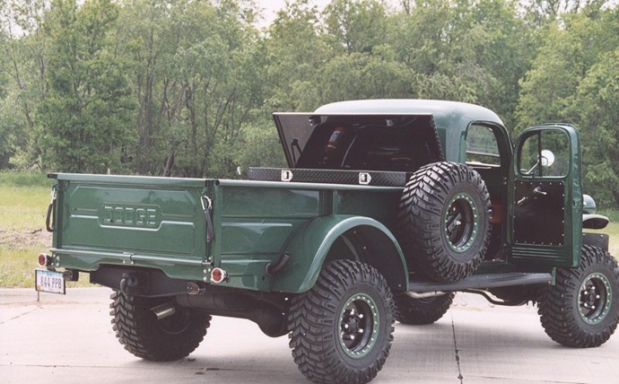

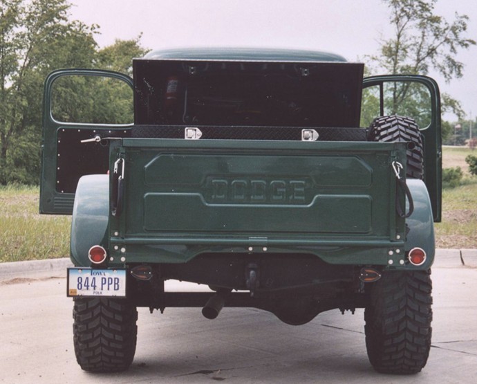

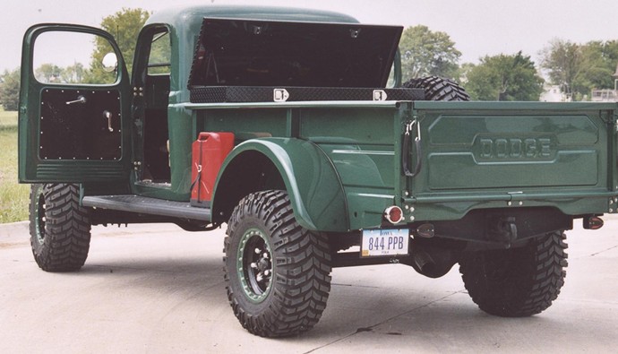

    A year after calling the restoration of Fenway complete, I've got Fenway's tailgate painted and hung. I had planned to paint the raised letters in black but my stencil guy didn't come through. Masking it would be nearly impossible for a novice like myself, so green it is. With some orange peel, it truly isn't my best work, but it's not going to Barrett-Jackson either. One other notable is the arrow turn signals mounted on the bottom of the rear valance. The are from Kevin Foust in Ohio.

    Nice looking truck Kevin, looks good with those combat rims. Will your truck be at the Rally? If so and you have an hour to spare I can paint your tailgate lettering while I'm out there if you want. Let me know and I'll bring some black lettering enamal on the trip out. Kevin in Rehoboth

      Kevin, I'll be there on Thursday and Friday, arriving sometime around noon. I would appreciate your help. Thank You and see you at the rally.

                    Dave, As far as the lettering is concerned I use "One Shot" lettering enamal which is available at some paint shops and art supply stores and online. It flows nicely and usually covers in one coat. As Kevin mentioned most of the Dodge scripts are done in white with the exception of white trucks that I've seen done with black lettering. For the application I do it freehand, you can mask but its tough with all the subtle curves in the embossing of the letters. The key is to get a good lettering brush with squirrel hair being the best . Long steady stroke are the key to a good looking job and paint down along the sides of each letter to where the embossing meets the flat of the tailgate face. I've seen some where only the flat tops of the letters were done and it doesn't look right ,you need to do the sloped sides to get the 2 dimentional effect. Practice on something first till you feel comfortable, it really isn't all that hard, just remember to breathe...it helps to steady the hand and don't rush it...put on some favorite music and your good to go! Kevin in Rehoboth
