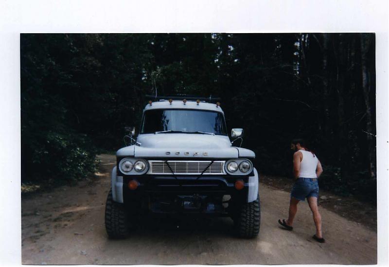

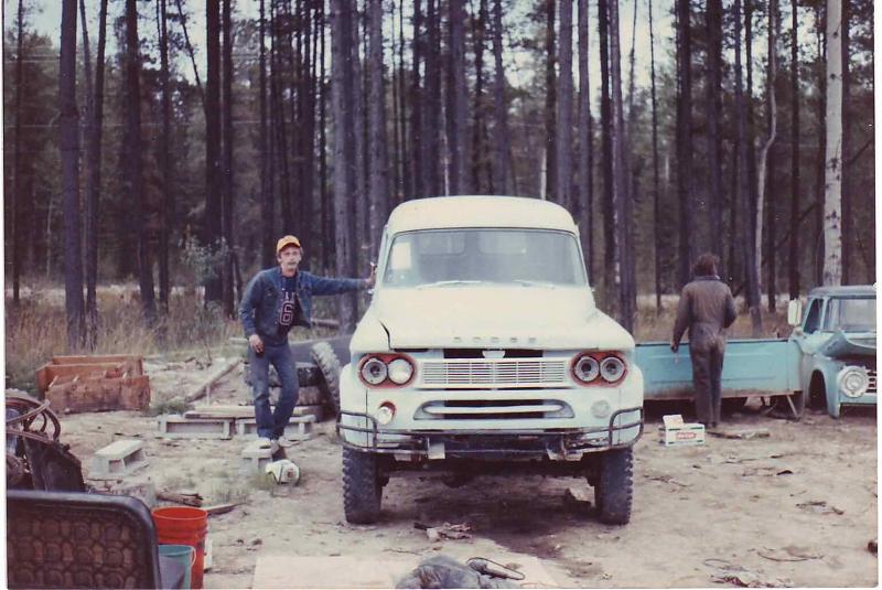

    First try at posting pics.This is Babe.Been a labour of love since 1984
    Not sure how to title these....
    1st pic is Tumbler Ridge BC Circa 1984(getting ready to lift body off to begin overhaul from frame up)Truck was found in Pouce Coupe a couple months before,Slant six(shot)running gear (shot,gears all welded)She was used as a farm tractor.The following week I found a 66 fargo 3/4 ton with PTO winch 318 wide block and good running gear(I towed babe up to TR behind the green beast(body parts on the right of pic),used a HiHab truckto lift off body to begin work.

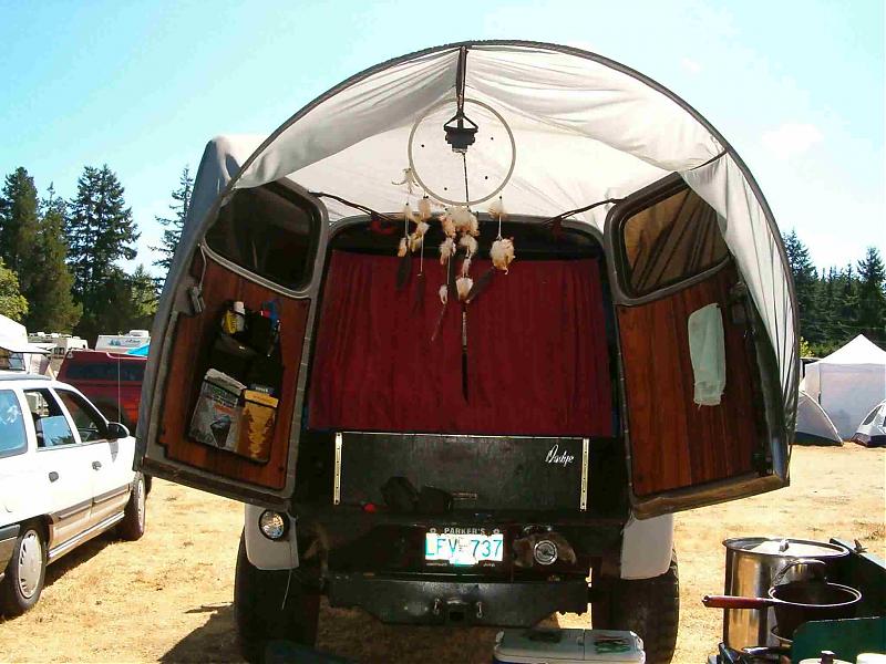

    Next pic is here in CR around 2000 .Last pick is just to show how my popup tent(cowl)is attached.

        My tent is completley colasible(fits in a bag) I used shock poles from a pup tent and extended them,then had a local seamstress copy my mock up ,using nylon.I also have a cook tent that i back up to(this tent slides underneath),for rainy season,(West coast on Vancouver Island),also have a small heater for warmth inside.I designed this about 15 yrs ago,and now I see them factory made(I think its for a Dodge SUV)If you want dimensions I could provide them for you(Takes 5 minutes to set up/knock down)The secret is the center pole and the way it clips onto the gutter.
        Running gear is Dana 44f 3200# axle ,dana 60 rear with limited slip.318 wide block engine (I modified a set of 289 headers),4 spd tranny and 2spd transfer case,with 1200# Bradon PTO winch(all rebuilt and running great!)Power steering is out of a 1972 Ford econovan(no frame modification!)getting ready to install power brakes and split hydralic system.Ive been able to insure as a station wagon,after I installed the rear folding seat.(Dodge Lebaron stn Wgn)I'm in the middle of preetying here up for the summer.New tires,drums brakes bearings and redoing the steering knuckes(was suprised that I could use ford knuckle seal kits)Dodge dealers are a complete waste of time,they dont seem too interested in older products.BTW , do I have to start a new thread to post more pics,or just delete and upload again?
