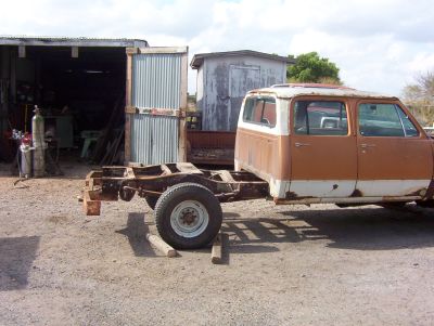

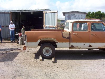

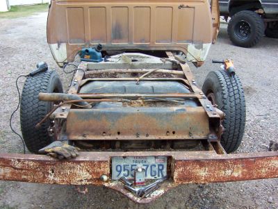

I'm new here and thought I would share some pics of my 1973 crewcab. I found the truck in a lot behind a ring and pinion shop. After some bartering I was able to bring the truck home for $288. It has a 360/727 with a divorced 205 in it. The axles are a dana 44HD with drums and a dana 60 rear. I have a dana 60 front axle with disk brakes that will be going in shortly. Originally it had the gas tank in the cab behind the rear bench seat, but I have removed it and put in a ramcharger gas tank between the frame. Originally I planned on putting a 360 magnum in, but now I'm leaning towards a 6BT cummings turbo diesel and a 2wd NV4500 to keep the 205 divorced. There are more pics on my RCC page http://ramchargercentral.com/boards/...topic=29363.50

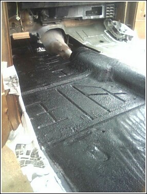

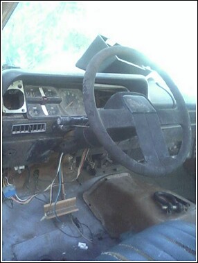

A few more pics. I cut out all the rust and welded in patch panels in the interior. I then primed the whole floor and sealed it up and then coated the whole thing in herculiner. I've also got a pic on there for my 1986 tilt steering column for anybody that would like to see a tilt steering column in a 70s truck.

The column bolted right up to the firewall. The hole in the dash for the column was a bit small and I had to enlarge it with my die grinder. The large plug, 8 wire I think, hooked right up to the column and the wiring is identical for that. For the ignition switch I've had to rewire to keep the 80s style switch.Originally posted by Big Joe View PostDid your 86 steering column bolt right up without problems?
Also did the 2 wire connector plugs for the 86 column hook right up or did you have to do a re-wire.
thanks
Big Joe
