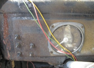

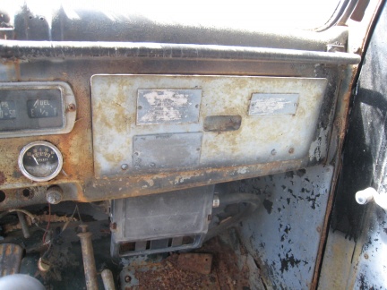

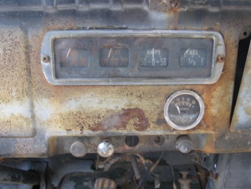

    A friend of mine wants me to fix up his old powerwagon. Since I have only done WC's and M37s I need some info please. Mainly I need the year this sucker was made and any photos of how the side lights etc are. Here are some pics of the dash, my guess is 47 as the dash is quite similar to the dash on my WC53 in general appearance..Any help would be much appreciated so I can start gathering the right parts and acces. or it.
    Thanks for any help
    Eric

    Instrument configuration alone makes this no older than '54 or '55. Get the serial number off the front left frame rail (near the shock top mount) to get an accurate date.

      Thanks, CD, will check on that the next time I am up there with it. Appreciate the reply back..Cheers...Eric
        The cluster changed to the center in mid "51"
        So it's no older than that.
        By no means, it's a 47

          Great, Tom. Thanks for the reply. Like I said, it was just a guess, as I usually only work on military. All the help is appreciated..Cheers...Eric

            Guess I was off a couple of years...thanks for the correction!
