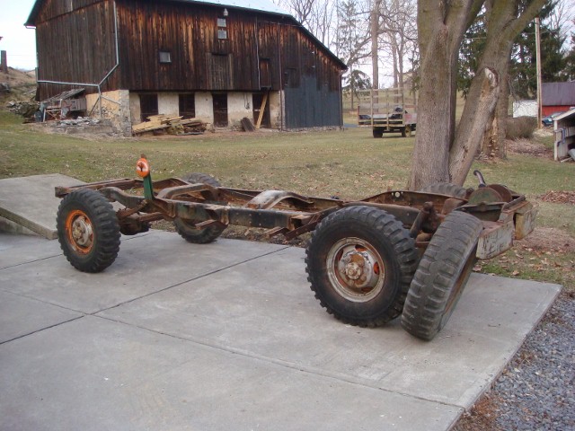

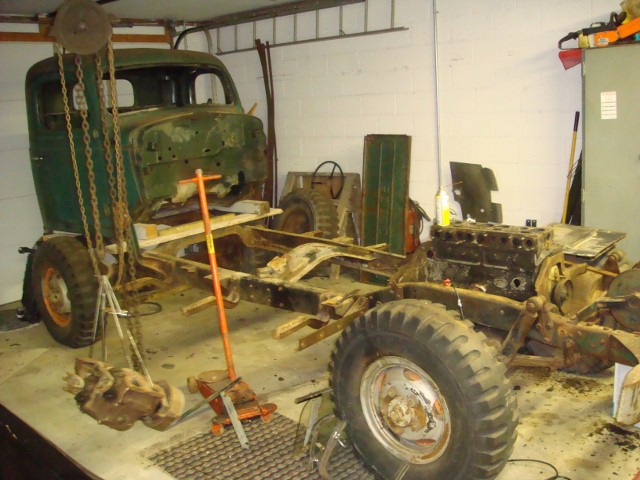

    I have already completed this old workhorse, except for some minor details. But I would like to share some of the pics that I have from along the way. These first few are of the disassembly process. Although this truck is over 60 years old the only bolts that had to be cut were where the wood used to be in the bed otherwise all others were turned off.

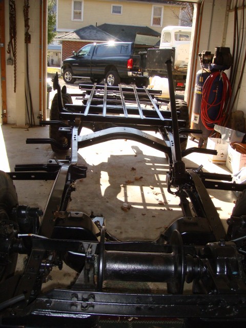

    Progress

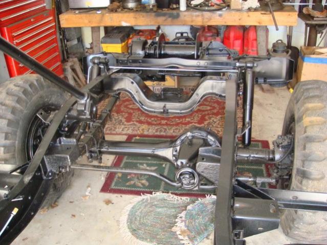

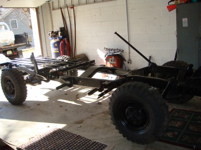

    Everything was blasted frame, axles, rims and sheet metal then given a coat of paint. This all happened over about six months as I brought the peices to the blasters a little at a time. Great people there at Blastco. They normally do water towers and such along with industrial stuff at their shop. They have a website, if interested. All new Brake and fuel lines, wheel and master cylinders and go through all mechanicals. this truck probably was stopped being used because someone put the clutch disc in backwards. Motor was converted to propane carbeurator. Gas tank had an oil mixture in it-no damage/rust in tank. Cleaned it out and good to go. Here are a few pics of chassis.

      forget the truck, I want the barn!!
        Barn
        I would love to own the barn to. It is part of my neighbors property. He has a few stock animals from time to time and years ago it was a dairy operation. Hope things are going well for you.

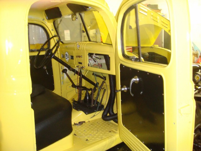

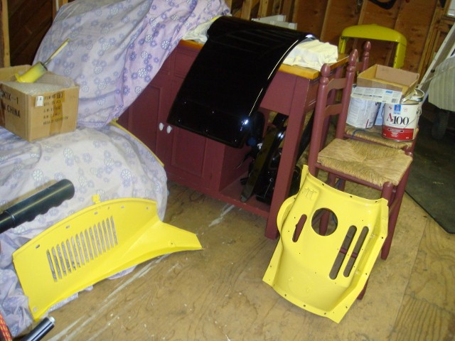

            Progress II

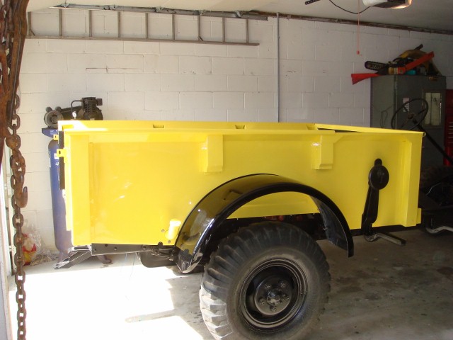

            I've got the chassis, fuel tank and rears cleaned painted and installed. The pickup box now goes together in place. After was body work completed and painted. Friends have advised me to convert to 12 volt, small block V8, later rears etc. and everyone here knows all the rest of the advice for changes. However, since this truck was in very good condition (except for the wiring harness) I have decided to keep it as built by Dodge. I like the purist method/look. I have been told that the lights would not be bright enough, but after cleaning sanding and having clean/continuous grounds the lights are as bright as any vehicle on the road today. Enjoy these few pics of the pickup box.
              Looks great njjim
              Nice work njjim,
              I am starting to work on my 56 fargo box again after taking the winter off with other commintments so to see somebody get ahead of me with a finished box totally inspires me.
              Thanks for sharing!

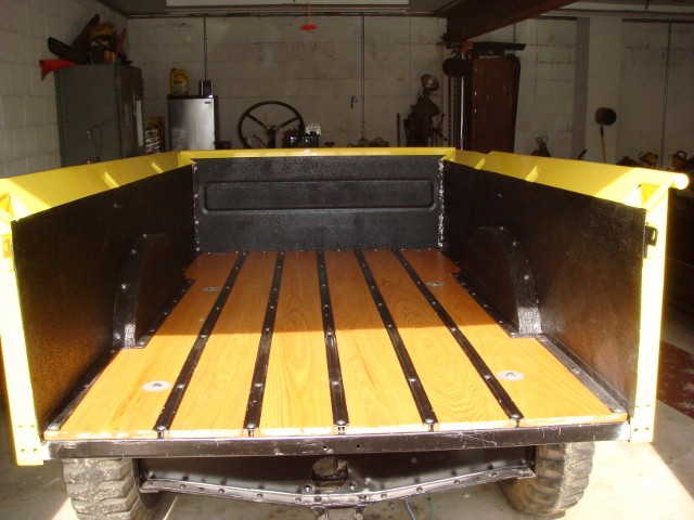

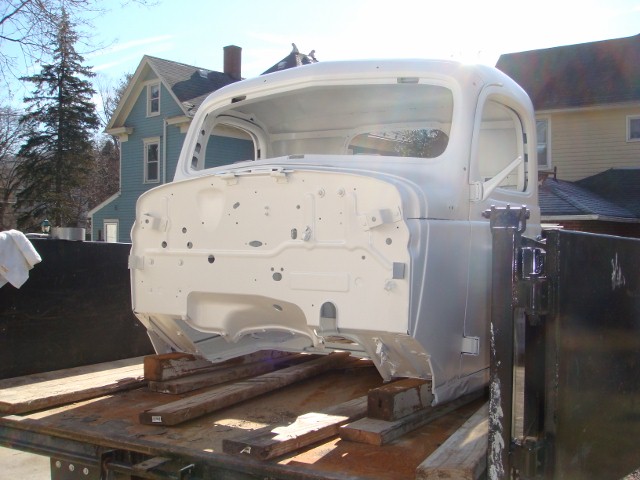

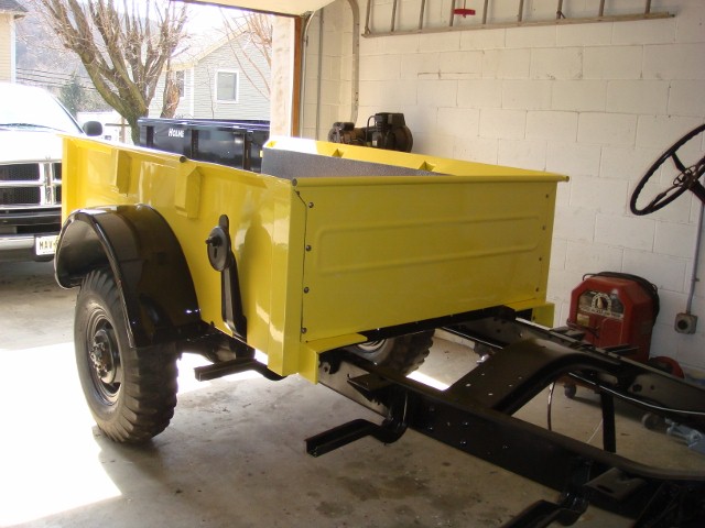

                Progress III

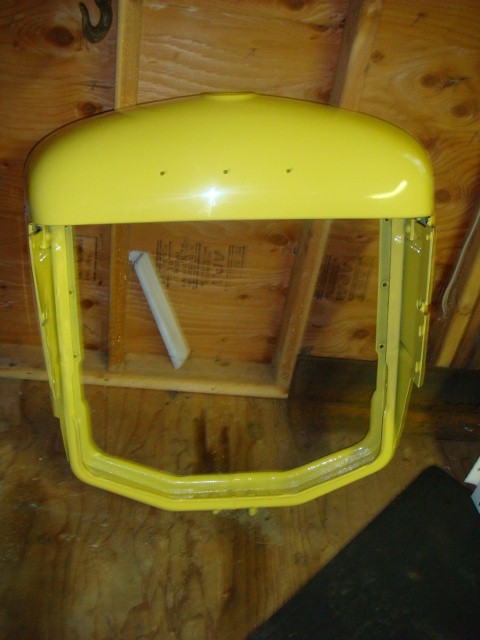

                The pickup box has been put together and the inside given a coat of bed liner coating. It came out great. Now the cab is being worked on while the motor is at the machine shop getting new valve seats, cylinders honed, and surfaces of head/block planned. I have found a NOS carbeurator for a Dodge truck at a swap meet. This will replace the propane carb that was on the truck when I purchased it. I think that I am going to put together my own wire harness with original braided wires from RIW instead of a whole harness. This will save some $. Once the cab is together I will get all the glass taken care of. Enjoy these few pics.

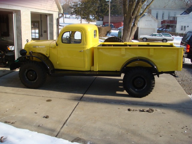

                  Progress III

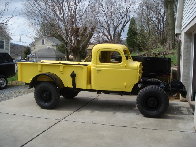

                  I have put the motor together and installed it, the trans and all the drive shafts, which had all been rebuilt. All the glass was put back into the cab with new channels and sweeps. The windshield regulator and side windows all work fine. I was having trouble with the fuel gauge. But, I located the trouble-the contact points on the gauge were burnt. They were cleaned and the gauge now works. Radiator, cowl, hood and splash pans installed. The motor turned over twice and fired up. What a sweet sound and a great feeling to have this machine back to life.
                    Just beautiful, thank you for sharing.
                      Wow!
                      NJJIM,
                      That is one gorgeous truck! One day I hope to have one as nice!

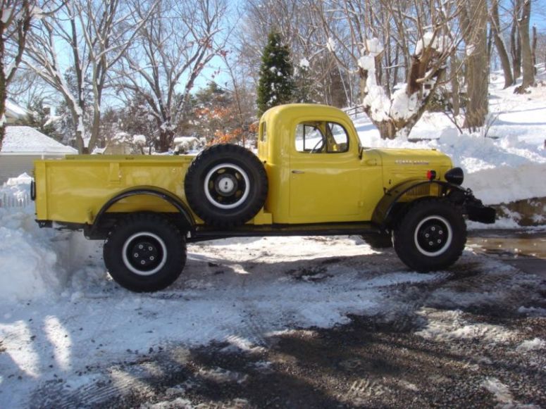

                          Jersey Snow
                          Yes, I,ll send you an E-Mail. Here is a picture of the B1 after the last snowfall here in New Jersey. I did have the truck out for some exercise.
                          I just cannot go for more than two weeks without driving it.
