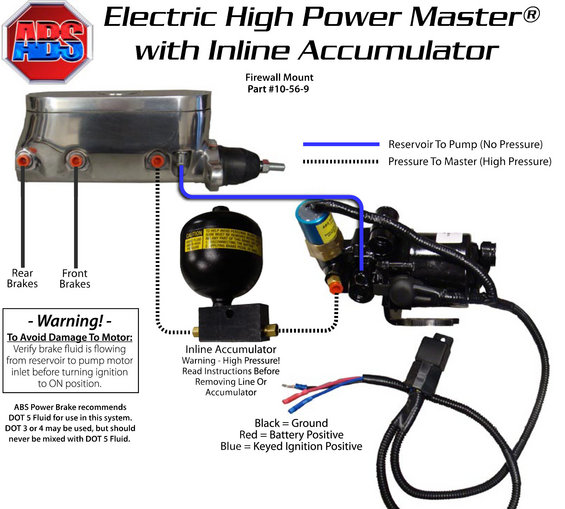

                                Then there's the ABS remote electric/hydraulic setup that's made for dual circuit brakes, as well as for their under floor mounted master cylinder which they also have with a remote reservoir you can mount under hood.. Dunno exactly how well I would trust it though I suppose if the pump goes out you still have unboosted brakes.
                                Seems like a real clean setup though.
                                Here's a pic of how it sets up...
