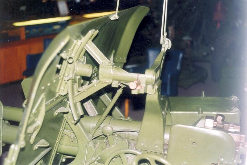

Here's a picture of one in a Museum , you can see where the optics slide in.

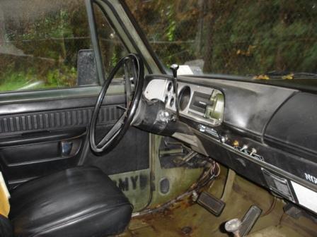

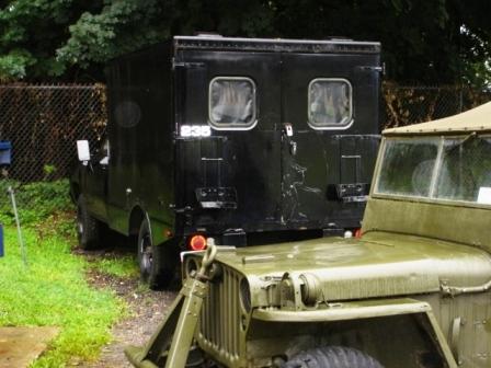

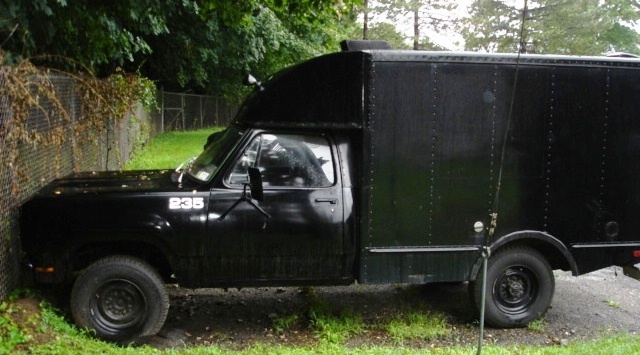

Hi Greg ...I took a few more shots of it for you tonight. Our Police dept got it from the Gov, painted it Black and used it as a Swat truck . Problem was , nobody liked driving it because of the manual steering ..that's why they auctioned it off with only 30K miles on it.Originally posted by padres84 View PostGreat pics!! Thanks for sharing...got any more of the 886?
The inside is still OD Green and luckily they didn't modify anything ..so it won't be very hard to bring it back to original Military config.
I remember reading an article in Military Vehicles that said they only made 4000 of the M886's so , who knows how many are left around today..I'm sure the day will come when they'll be hard to find.

Thanks for the pics...I kind of like the black, but I wouldnt paint mine that color down here in FLA. We are painting mine in two Sunday's back to OD. Mine is OD on the inside also...so some scuffing, sanding and Ill bring her back to org color.Originally posted by Mike Peters View PostHi Greg ...I took a few more shots of it for you tonight. Our Police dept got it from the Gov, painted it Black and used it as a Swat truck . Problem was , nobody liked driving it because of the manual steering ..that's why they auctioned it off with only 30K miles on it.
