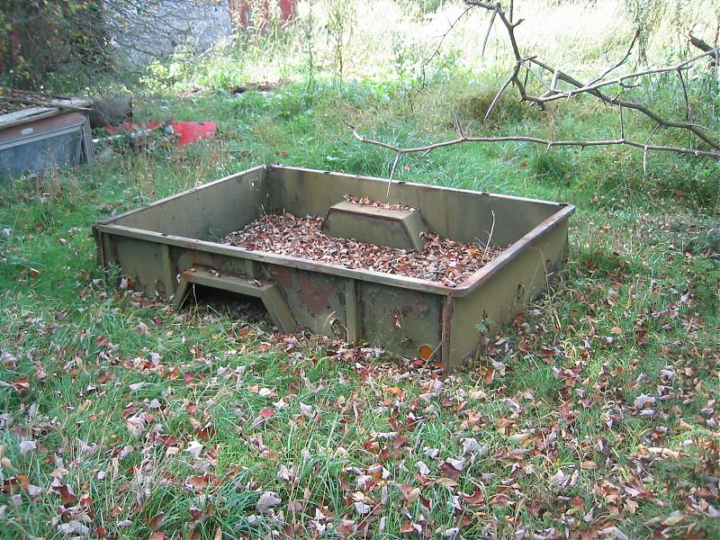

This truck bed is located at the farm where I am scrapping out a bunch of farm implements. Just curious as to what it goes to.
Can someone identify this military truck bed?
I guess I can measure it the next time I am at the farm. It is one of the things that I can take with me. I figured that I would put it on ebay but wasn't sure what to list it under.Originally posted by HWooldridge View PostI can't tell size from the pic but it looks like a 2-1/2 ton trailer bed. They are **** for stout if you can grab it and slap it on a good single axle frame.
That is an old Army surplus "bed".They surplused mess of them around here back in the late 70's.Seemed like every farm truck in eastern Ohio and Western PA had them at one time.It will bolt right on a 70's era Ford pickup.Nice get,don't scrap it.Anything else neat in the farm pile?I wonder how that would look on my W200?And I have seen one on a FFPW.
If you are interested, you are welcome to take a look at it and make an offer. I plan on posting some pics of the farm stuff here soon, might be going back for a few more photos.Originally posted by The Other Ross View PostThat is an old Army surplus "bed".They surplused mess of them around here back in the late 70's.Seemed like every farm truck in eastern Ohio and Western PA had them at one time.It will bolt right on a 70's era Ford pickup.Nice get,don't scrap it.Anything else neat in the farm pile?I wonder how that would look on my W200?And I have seen one on a FFPW.
It's not an M101, it's too big for that.

Added today, 12-22, I beg your pardon Keith! For whatever reason the 1/4 and 3/4 ton trailers are BOTH designated M101?? Not like the military to run out of numbers....= )
So if it's a 3/4 ton it's also an M101.
What is the distance from the front bulkhead to the axle centerline? Wondering if it would work as a bed on an M715?
trailer boxes

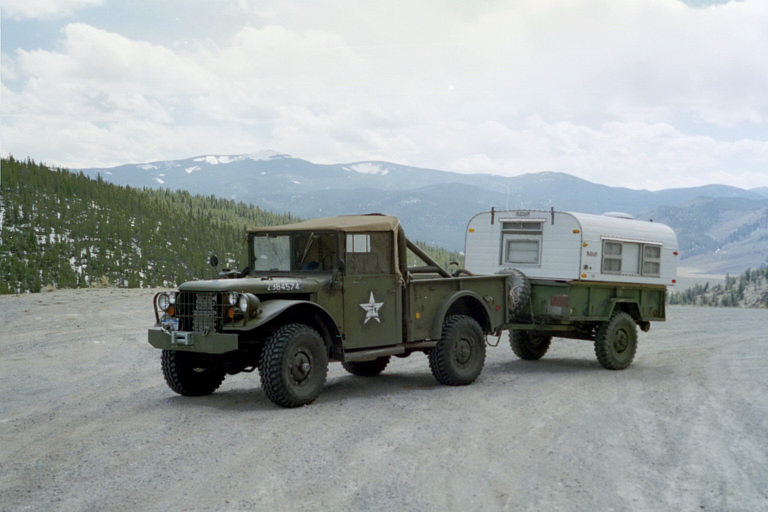

I am not familar with the 1/4 ton trailer designations. Part of the confusion may be the abbreviation. My trailer is actually an M101A1. I've also owned an M101A2 which differs from the A1 in that it has 8 lug wheels and a surge hitch - boxes look very similar.Originally posted by MoparNorm View PostFor whatever reason the 1/4 and 3/4 ton trailers are BOTH designated M101? . . . What is the distance from the front bulkhead to the axle centerline? Wondering if it would work as a bed on an M715?
The distance from the outside of the bulkhead to the axle centerline on the M101A1 is about 54". It is about 58" on the M105. Since these trailer boxes are constructed using mostly flat and square surfaces, the wheel opening can be easily modified to accomodate different lengths and widths. I opened up the wheel tub width from 46" to 49" to fit my Alaskan, and I've sectioned 2' of width and about 2' of length on an M105 bed for a pick-up truck box I am working on. Govliquidation has sold lots of these 3/4 and 1.5 ton boxes for dirt cheap.
