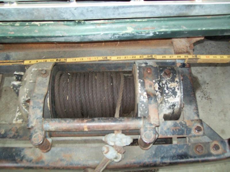

Lu-2
Don't have one, but a Braden LU-2 might be a good fit. As I recall, they are lighter than the MU-2 and are era correct for your truck. There may be one for sale at www.powerwagonparts.com .

Oldred89,
I personally think that your goal is quite doable if you can weld. I recall mounting an LU-2 behind the cab of an old PW that already had an MU-2 on the front. As I remember, it wasn't that heavy (relatively speaking.) Since you intend to run off separate ptos you won't face the problem of rotating disconnected shafts. You will need to be able to disconnect the shafts at the winch. I suggest trying to find an LU-2 that comes with the shaft(s) etc that came off a truck similar to yours and first mounting it on the front. You will then have to make up the mounts and driveline setup for the rear. Taken in stages it should be fun.
