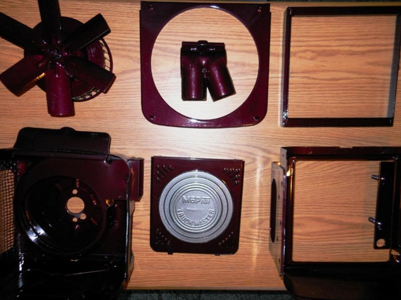

You might want to consider upgrading your heater motor to 12V as well. I had my model 65 torn apart to sand blast and paint anyway and found this 12V motor works well. You have to trim the shaft after installation.
Four Seasons/Trumark Blower Motor without wheel - $37 http://www.amazon.com/Four-Seasons-T.../dp/B000CNHAK8
