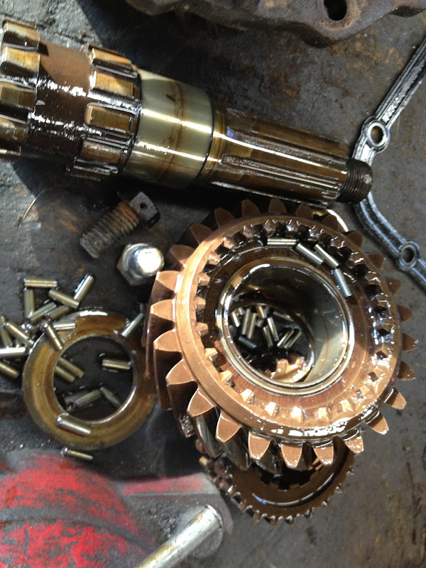

                      • Originally posted by jrodjared View Post
                        Houston, we have a problem.
                        The rollers go into the big gear in two rows seperated by that metal washer. You can see the line on the inside of the gear where the washer was. As Wayneh stated, dip them in some grease and they'll stick in place while you put it all back together.
                        Also, might want to paint the interior with some Glyptol like the transmission. Will help to seal any porosity in the casting and speed oil drainback. Plus keep any surface rust from forming while it sits waiting to be used.
                        The greasy stuff isn't fun, but the the nastier it is the better it looks when you're done!
