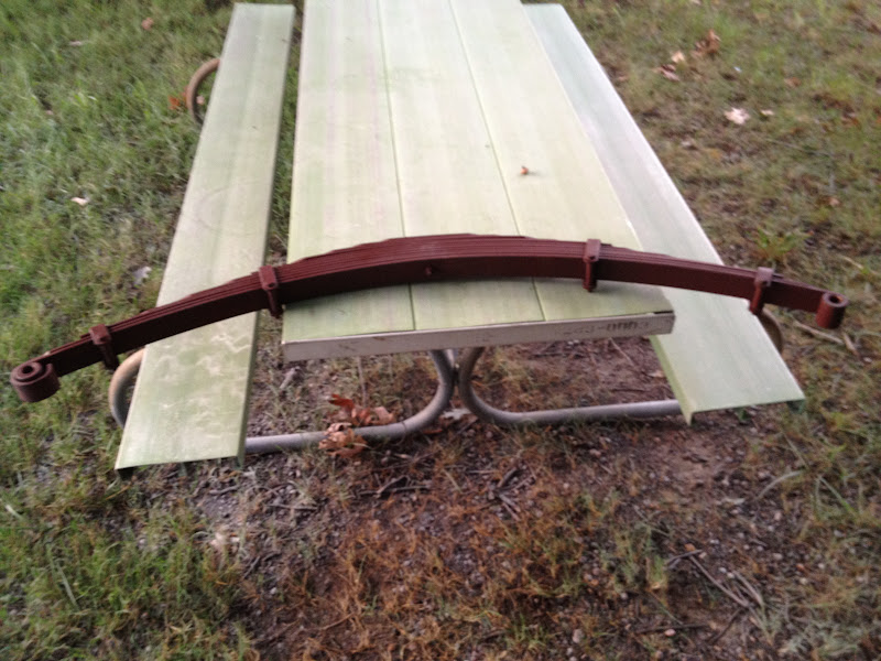

    I'm leaning towards having these springs re-arched rather than replacing them. Can anyone chime in with some pros and cons?
    • All cleaned up.
      A light coat of primer to keep it fresh.

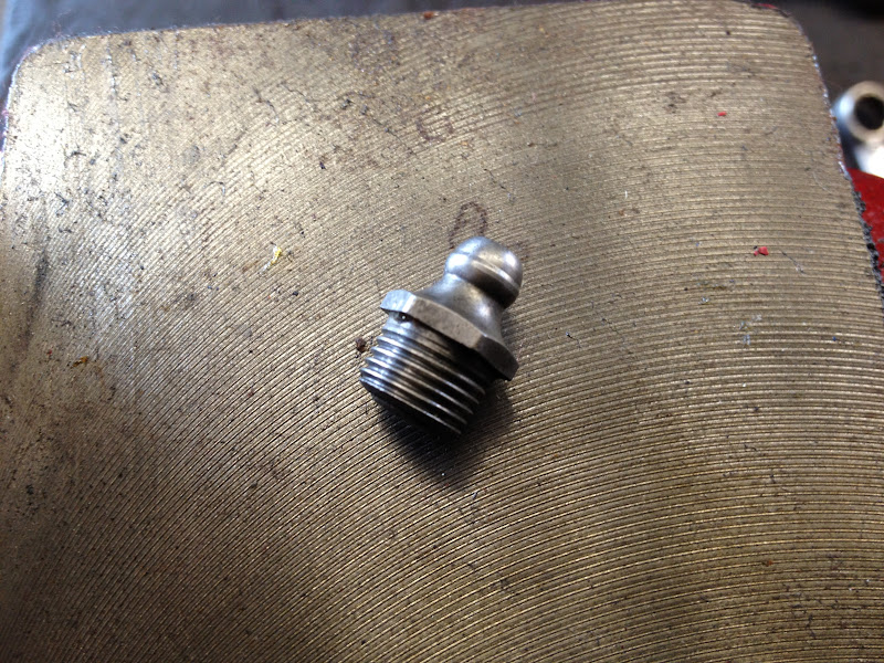

        Cleaned up the threads on the zerk fitting itself while it was off.

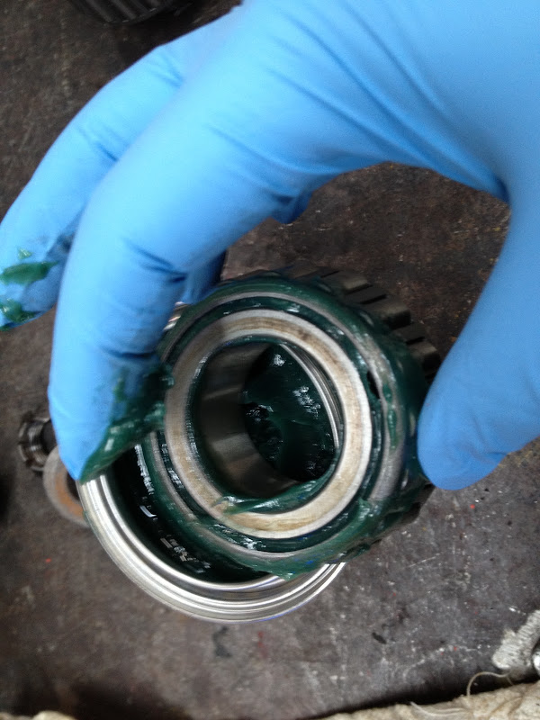

            Started by coating the inside with Glyptol to seal it.
            It look REALLY good, although we shall see how well it actually works.

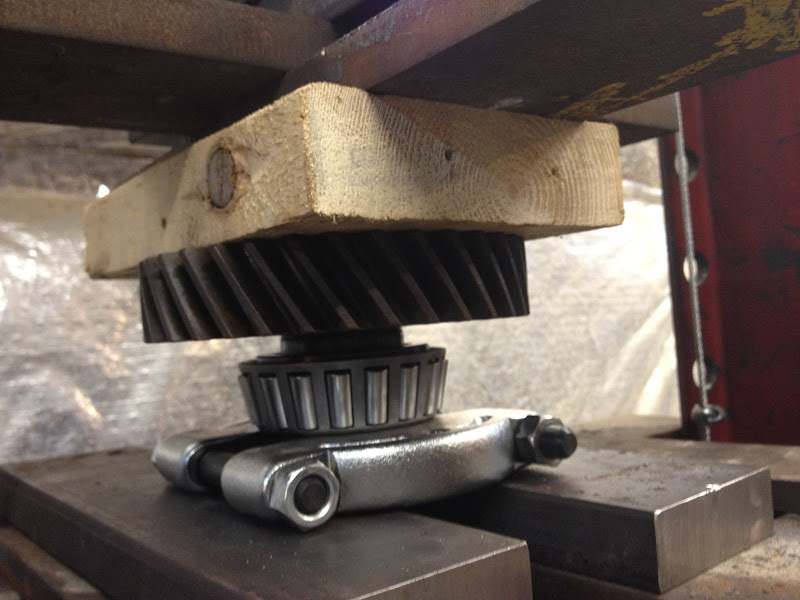

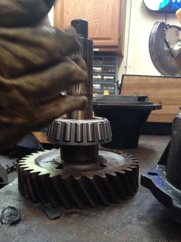

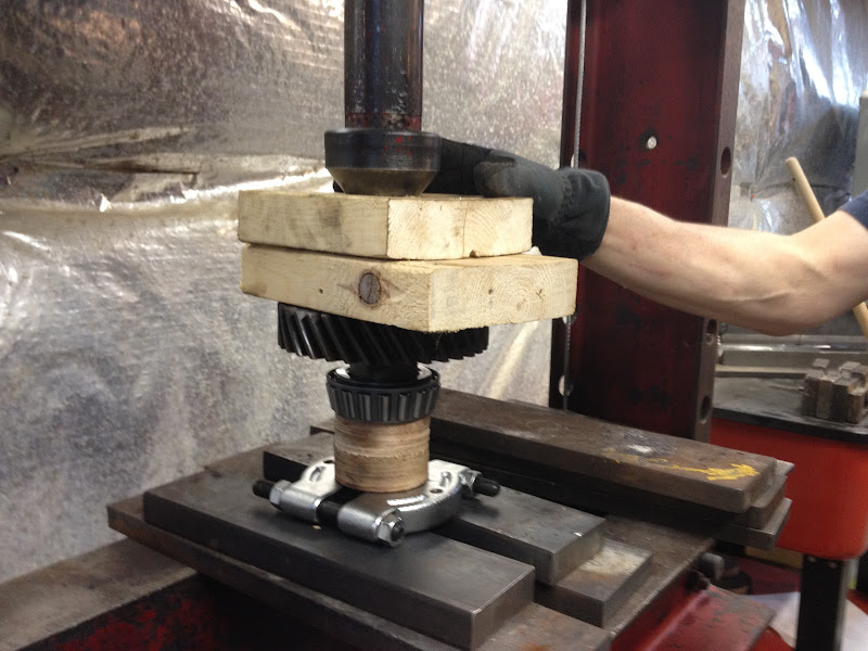

              • Sliding new bearings on. This one was a little difficult.
                Hmm, can't seem to get it to go down any further. We had heated up the bearing in a toaster oven to make it expand, but it wasn't doing the trick.
                • When slamming it with a hammer doesn't work, try a press.

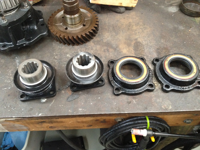

                  New oil seals.
                  • Ready Sleeves, ready.
                    E-brake assembly put together.
                    Me banging in the rest of the ready sleeves.
                    • Pic of sleeves and seals.

                      • The second side Wayne got smart and put the gear in the freezer. Once the bearing was in the toaster oven for a bit, the two slid together pretty easy, no press needed.

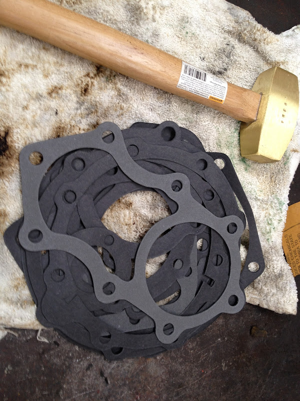

                        New gaskets all ready to go.

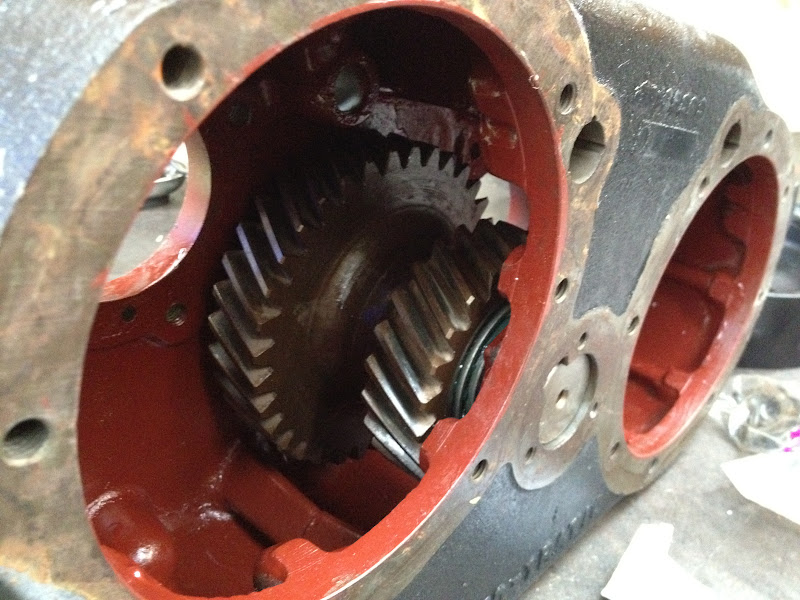

                        Got the idler gear installed first. Putting on the end cap. At first I was a little confused which way it went, but after looking at the marks, it became pretty clear.

                            There's a shot of the idler gear installed before I put the end cap on.

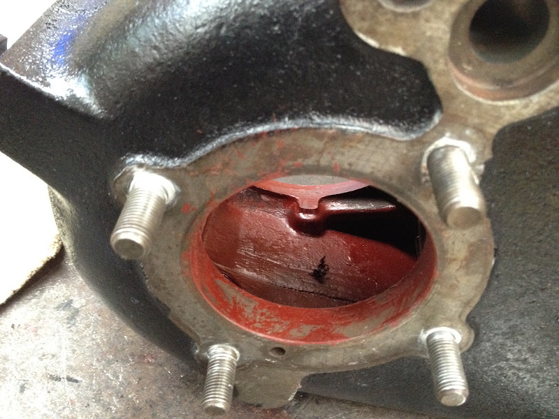

                              • Studs back in, cleaning up the edges before putting in new bearings.
