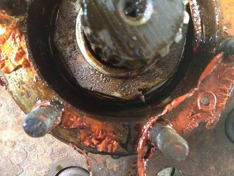

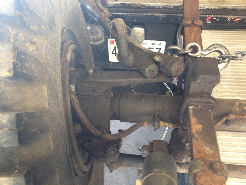

  • Just documenting everything before I tear it apart. What a friggin mess.
    • Gross
      • I think there was some water in here, but overall everything seems to be in solid shape. Granted I don't really know what I am looking at, but if I had to guess I would say we have something to work with.

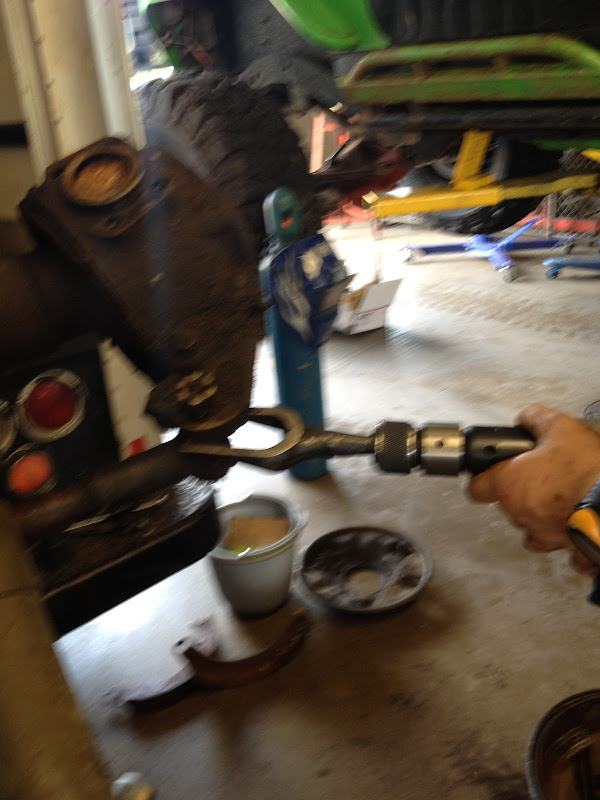

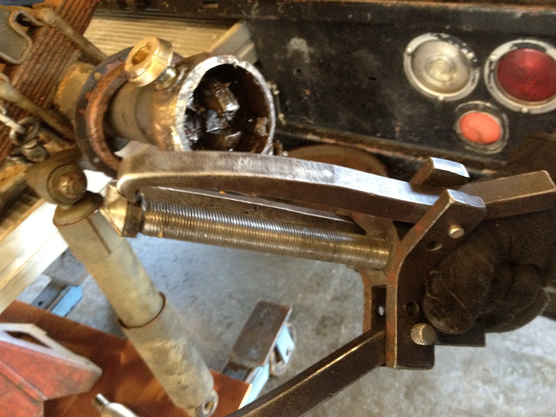

            • Need to get serious here. Can't get these bearings off.
              This ended up being a little too big. We used one about 1/3 the size, it did the trick.

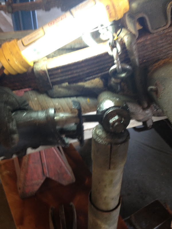

              Had to resort to the saws-all.
              • Maybe we can coax it off with some heat?
                Or maybe we can just pulverize it with an acetylene torch.

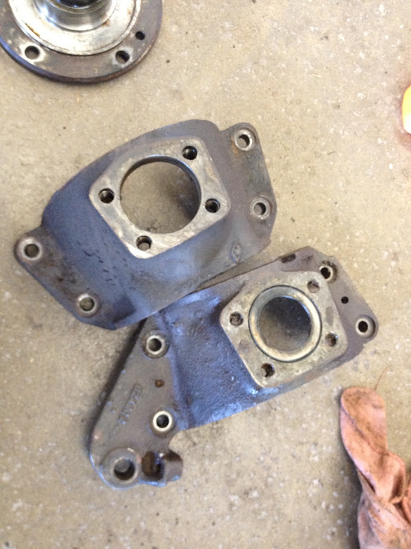

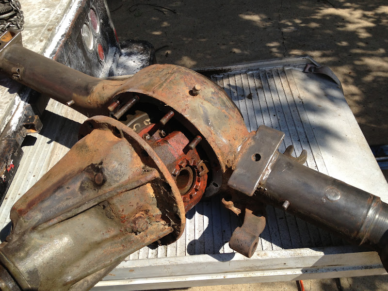

                • Discovered that these mounting plates were welded to the axle. The other side's brackets came right off. Is this normal?
                  No problem on this side.
                  There she is, all stripped down. Time to clean!

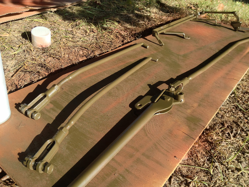

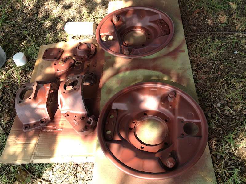

                  • Some pieces after being wire-wheeled, soda blasted and primed.
                    Got some work to do here.

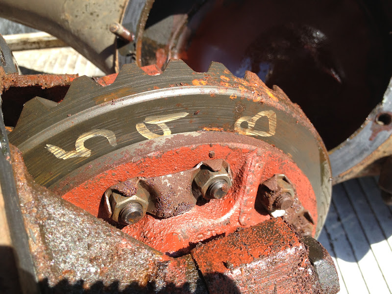

                    • Pulling apart the 3rd member.
                      • Noticed some interesting markings. Guess this has something to do with the 5.9 gear ratio?

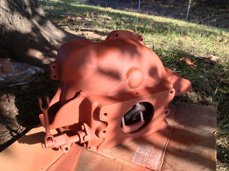

                          • After much grinding and blasting, the first layers of primer are applied. I love this part.
