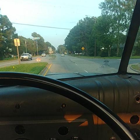

            I've also been trying to figure out what is wrong with my transmission. I have a weird rattle / Growl from the Torque Converter when it is at lockup pressure in 4th and 5th gears. Stupid Allison. I attached a link to a video.
            146 Likes, 4 Comments - Alex J (@powerwagonbuilder) on Instagram: “Video of 1200° EGT and about 18 psi boost. The #allison1000 is making a weird converter rattle in…”

              I have never heard an Allison make that noise before? If by chance you pull it manually into a lower gear not allowing it to go into 4th or 5th no noise right?
