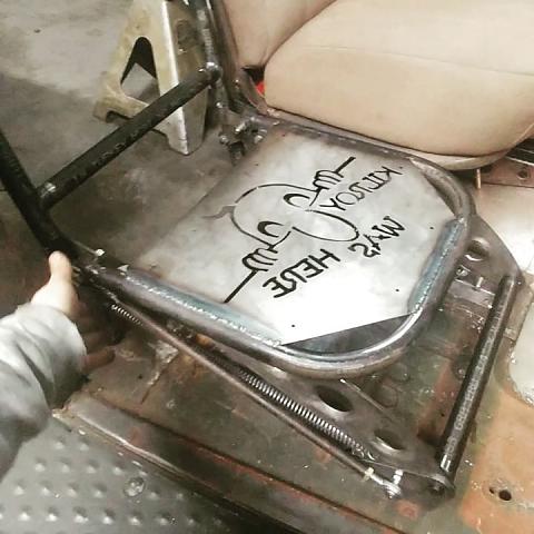

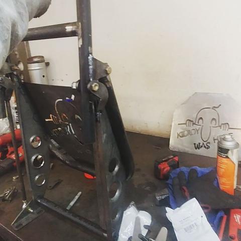

        I'm going to try and insert some pictures of the seat frame. My front seats have a higher back rest than the original seats just for the sake of comfort and safety. They fully support to the top of my shoulders at 6'0" tall, medium build. Nobody tall or large is ever driving this truck comfortably, but I don't care about that. That being the case, the seat back was too tall to fold over and tumble like the original jump seat, so instead I am working out a mechanism that makes the seat stand up in a vertical manner and gets close to the windsheild. It can't be up when the door is open, but that would be a rare instance anyways and not at all a deal breaker. Will be easy to remove too. I am hoping to give it some torsion spring assist too so that it can be lifted easily and will stand in the up position. Of course I had to add some touches to under the seat cushion, that can only be seen when the seat is flipped up to exit the back of the truck through the passenger's door.
        Its still a work in progress and I don't get much done each time messing with it, however I am putting a detailed effort into it because I want it to work right, fit right, and just overall be nice. I am using some aircraft style hardware and linkages, and the dimple dies, of course to give it that hot rod aviation look, but not look like its too out of place. Jim's eye seems to be the good calibration of what is sci-fi WW2 or not.

              Here is how the arc of the seat works. Only spent 20 minutes on it yesterday before going to play with some old axles and re-organize my storage unit to try and get rid of some stuff I don't see myself using.

              • That seat is really cool! I have an original and it's kinda' so so. When you lean back in that seat, it looks like there is going to be a massive pressure put on that lower rod. Is there a stop somewhere that stops the seat back from leaning back too far?

                  The ratio on the rod is if you put 250 lbs on the top of the frame in a rotation around the hinge axis, you are creating 1600 lbs of force into the rod, ignoring losses from friction in the hinge points. There are two rods so that is 800 lbs per rod in compression. The rods are 1/2" solid stock A36 mild steel and the rod ends are 3/8" captured spherical joints that go through some 1/8" HRPO Grade A50 plate. Without doing a full analysis and actually wrenching on the frame by hand and watching what moves, it appears that my weak spot are the webs of the hinge to floor plates where the rod ends go through. They create some Z plane bending from the eccentric loading of the rods. My solution to that will be to machine a rod that spans across between the two brackets and the rod ends can thread into it.
                  My next feat will be coming up with a positive latching mechanism that doesn't create a clothing snagging point during enter / exit, but can be unlatched from both the side getting in and also from the back if people are in the back.
                  I added some springs to help lift the weight of the seat and to hold it in the up position safely. The hinge bolts are snugged tight at the moment, I think once I add the weight of the cushions and backer panels and such it will be pretty much perfect.
